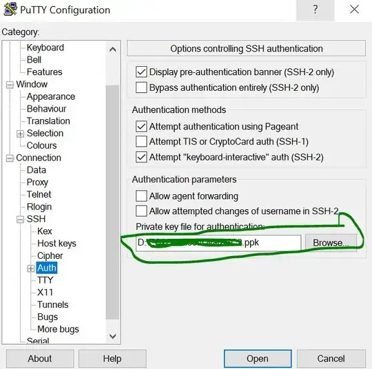

In Putty, You need to set the configurations: -->Connection-->SSH-->Auth-->load ppk file enter image description here Replace the xterm with putty-256color
Connection->Data->Terminal-Type-String-> putty-256color enter image description here
Note: Go to session-> click save button to save the configuration.
