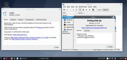

Really you can upgrade pcmanfm-qt and other LxQt components to latest versions using “Lubuntu Continuous Integration” team – UNSTABLE CI Output - Proposed Pocket PPA.
But be careful as maintainers warn users with "⚠️ This PPA is not meant to be used ⚠️" message.
Add the above PPA and then install packages from it using commands below:
sudo add-apt-repository ppa:lubuntu-ci/unstable-ci-proposed
sudo apt-get update
sudo apt-get install pcmanfm-qt
sudo apt-get dist-upgrade
sudo apt-get autoremove --purge
to get LxQt 0.16 with PcManFm-Qt 0.17:
LxQt from PPA
