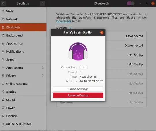

At first it was not even detected, however after I followed the instruction on this link it got detected and was shown in the Bluetooth devices list, it still can't connect, and the toggle button seems to be locked.
As you can see, there isn't the yellow halo around the toggle button.

First get the MAC Address of the headphones. If your headphones are visible in the bluetooth settings (like in the screenshot) you can just copy from there. Otherwise go into terminal and type bluetoothctl. Then try to connect the studio buds like normal (lid open hold down button on case). A MAC address should pop up on the screen. You can verify that it's the headphones address with info <address> and it should show something like Name: LE-Beats Studio Buds
