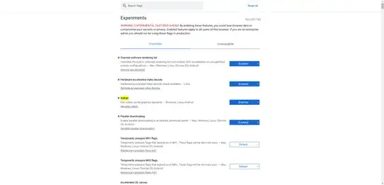

flags enabled: enter image description here

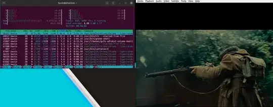

CPU usage on vlc with 4k video h265, vlc is on second line, gnome for some reason takes a HUGE screenshot (6MB, had to compress): enter image description here

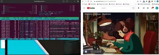

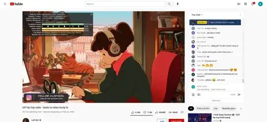

CPU usage chrome + youtube: enter image description here Stats for nerds: enter image description here

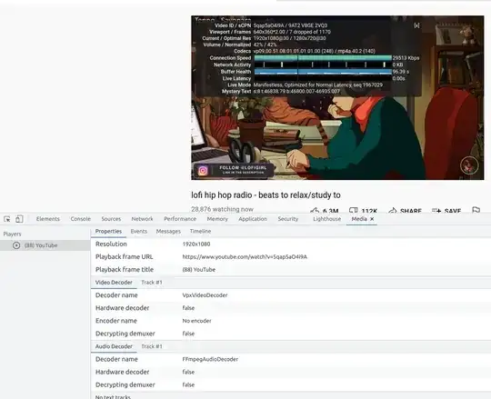

EDIT 2: Following along with what Michal Przybylowicz said, it looks like the decoder is not a hardware decoder? What is going on here? Why isnt chome or ubuntu using the hardware decoder? enter image description here
