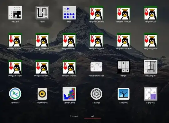

I made the grave mistake of running the command sudo apt-get install -y games-minesweeper thinking it would only install one game. It ended up installing like 30 or so games:
installed games
The problem is i can't uninstall these packages since they don't show up in the Ubuntu software app, and running:
sudo apt-get remove games-minesweeper
only returns:
Package 'games-minesweeper' is not installed, so not removed
I've also tried to run sudo apt-get remove <AppName> and it hasn't found any of the games' packages by the name of the application.
I've tried to also run sudo apt-get remove <Debian Package ID> and it hasn't found any of the games' packages by that either.
How do i uninstall these packages, or find out their package name? so i can run sudo apt-get remove

You have to locate their package names by using commands like
dpkg -S $(grep -r Penguins --include=*.desktop /usr/ 2> /dev/null --files-with-matches)
where grep -r Penguins --include=*.desktop /usr/ 2> /dev/null --files-with-matches running recursive search for Penguins in /usr folder and list the names of found *.desktop files. Then dpkg -S … finds corresponding package names for found files.
Penguins… came from ace-of-penguins package. Remove them with
sudo apt-get remove ace-of-penguins
