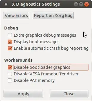

Try turning off the bootloader graphics. Run this command in a Terminal window:
gksudo xdiagnose
Click the checkbox labeled "Disable bootloader graphics", hit Apply, then reboot.
If you want to report a bug on this, I'd suggest turning on the graphics debug messages (first checkbox above), reproducing the bug, and then collecting the output of dmesg.
Beyond that, see http://wiki.ubuntu.com/X/Troubleshooting/BlankScreen for other common ways to diagnose these types of issues. I also have a more in-depth explanation of what happens to cause blank / black screens written up there, if you really want to know what's going on.
