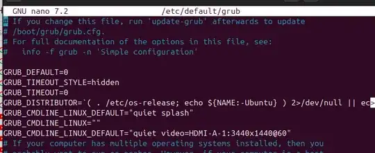

I know it's late but xrandr is broken in my case dummy HDMI display had no ultra resolution 3440x1440 I found this post about Wayland: https://www.davejansen.com/add-custom-resolution-and-refresh-rate-when-using-wayland-gnome/ In nutshell you have to find your port name:
ls /sys/class/drm/card*
in my case card1-HDMI-A-1 port is HDMI-A-1
edit GRUB:
sudo nano /etc/default/grub
add GRUB cmd line with following structure:
GRUB_CMDLINE_LINUX_DEFAULT="quiet video=<port-name>:<resolution-w>x<resolution-h>@<refresh-rate>"
e.g.
GRUB_CMDLINE_LINUX_DEFAULT="quiet video=HDMI-A-1:3440x1440@60"
then sudo update-grub and restart
sample config:
GRUB config screen
