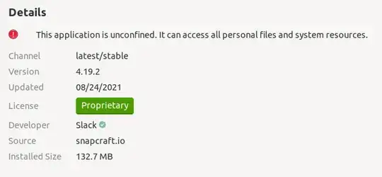

Presumably because I installed it from Ubuntu Software, so it's a Snap: Screenshot of Slack entry

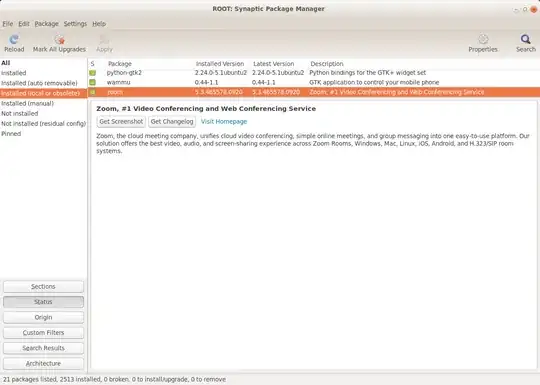

Install Synaptic Package Manager (you can install it from Ubuntu Software, or from command line using sudo apt install synaptic). It is a great tool to manage .deb packages. On the main screen, it shows you packages divided into groups, as you can see in the screenshot below. Look at group called "Installed (local or obsolete)" - these are packages that have been installed from manually downloaded files and not from repositories (some very essential system packages, like libc, are also included there). On my screenshot you can see zoom among those packages.
BTW. In your Slack example, the program is installed as snap, not a .deb package, which can be recognized by the presence of "Channel" at the beginning of the data on your screenshot. Snap packages always have a channel (usually latest/stable) while .deb packages don't. So neither apt nor Synaptic won't know anything about that package (in fact, in your example apt policy is showing you information about a non-installed slack package available to install as .deb from the repositories).
