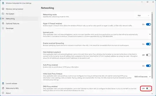

Using the WSL Settings app is the simplest method I've found so far. Disabling Networking -> DNS Proxy enabled option within the app solved the issue for me.
WSL Settings screen
It adds the following to %USERPROFILE%\.wslconfig:
[wsl2]
dnsProxy=false
In this method, /etc/wsl.conf should remain unchanged (meaning generateResolvConf left at its default enabled state).
