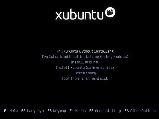

I'm making a custom system from Xubuntu (xubuntu-20.04.1-desktop-amd64) using Cubic (Custom Ubuntu ISO Creator) program.
When we turn on the computer with the installation media and press any key, that simple black screen appears with the options "Try Xubuntu without installing" and others.
How do I leave this behavior as the default? I want this screen to always pop up automatically without the need for user intervention.
In Lubuntu's ISO it's always like this. Which file should I modify to get this?
Boot Menu every Boot
When booting in BIOS mode Xubuntu uses the Syslinux menu from the txt.cfg file. Pressing the shift key will make the screen in your image appear, (along with the Language menu).
When booting in UEFI mode the GRUB menu from grub.cfg normally appears. Boot partitions can be added, (as with mkusb), to enable GRUB booting in BIOS mode also.
I do not think that you can boot via the Syslinux txt.cfg menu in UEFI mode.
The items on the grub.cfg menu are the same as on the Syslinux txt.cfg menu.
If you would like to boot to the GRUB menu in both BIOS and UEFI modes you can add boot partitions thus:
