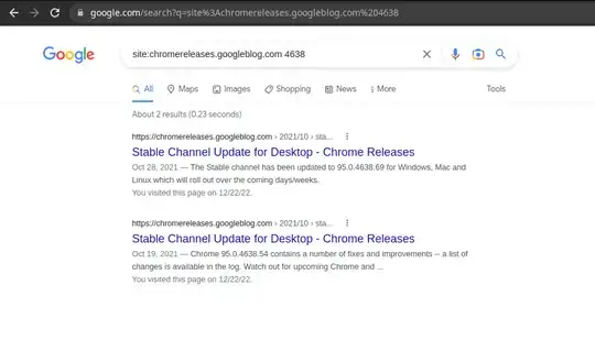

  1. Look in https://googlechromereleases.blogspot.com/search/label/Stable updates for the last time version 4638 was mentioned. There is a field which queries the general Google:

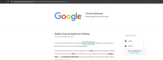

    Selected one of the above results and:

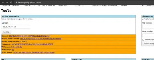

  2. Loop up that version history (specifically, 95.0.4638.69) in the Position Lookup;
  3. In this case it returns a base position of 920003. This is the commit of where the 95 release was branched, back in September 2021:

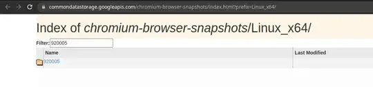

  4. Try searching in all required platforms (i.e. Linux, Linux x64, Windows, Windows x64, Mac etc.) on continuous builds archive - paste "920003" into the filter field at the top and wait for all the results to XHR in. If no results is shown, try incrementing or decrementing the value (i.e. 920004, 920005 etc.).
  5. Eventually, it showed 920005 at Linux x64:

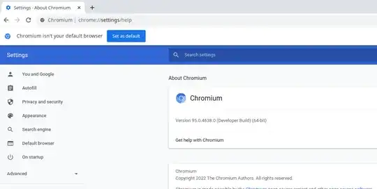

  7. Unzip and voilĂ :
