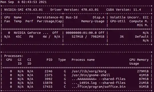

I've GEFORCE RTX 2070 on my laptop running Ubuntu 18.04 and had successfully installed its driver from the official runfile NVIDIA-Linux-x86_64-470.63.01.run. Here is the output of nvidia-smi from that installation:

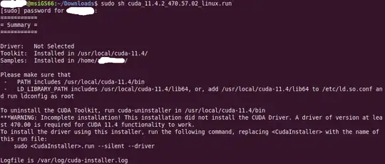

Next, I installed cuda-toolkit from the official runfile cuda_11.4.2_470.57.02_linux.run, making sure to un-select driver installation. Here's the terminal window right after installation completed:

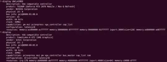

  • sudo lshw -c video : (NVIDIA display is "unclaimed", but this is how it should be)

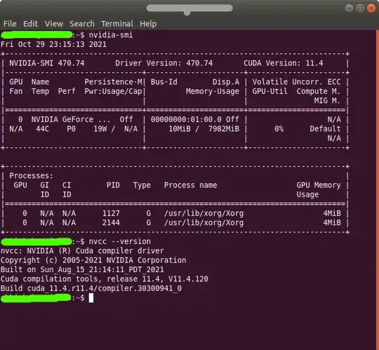

I purged all nvidia stuff and then tried sudo ubuntu-drivers autoinstall followed by sudo reboot after which nvidia-smi works fine.
So I guess the solution was to re-install NVIDIA drivers.
