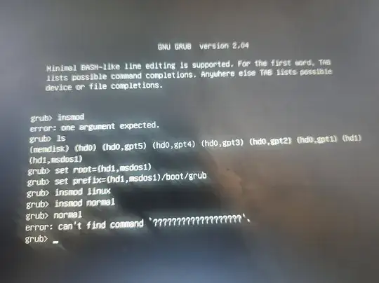

I am trying to install Ubuntu in UEFI mode in my laptop. I have downloaded the ISO file of Ubuntu and used Rufus to create a bootable drive with MBR or GPT option. When I tried to boot into the USB, all I am left is with the Grub Rescue terminal.
Here is the screenshots of the issue I am facing:
I have even tried to load it manually, but didn't help.

Finally, I made the USB to boot in my PC.
As shared by @C.S.Cameron , the issue that I was encountering is because of the corrupted ISO image. I downloaded a new image and used it to boot in my PC.
NOTE: Verifying the ISO image with its corresponding MD5 or SHA256 checksum can save considerable amount of time.
