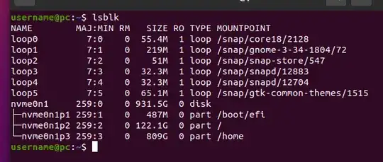

Moreover, it gets disconnected from system completely, so even lsblk output doesn't list it: enter image description here

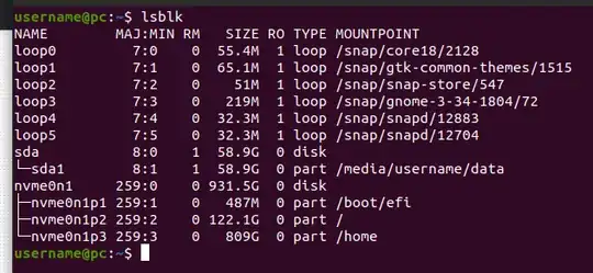

Here is an example of it's output when stick was just plugged in: enter image description here
When I stick it in after fresh reboot, all files are still there, and I perfectly can work with it. Still, after calling for GParted and being disconnected first time, if I replug it, it doesn't start properly as well, auto-disconnecting after some time.
Stick was working perfectly just an hour ago on Windows machine and my Ubuntu 20.04.3 system before I tried to format it, and works perfectly now after fresh reboot (until GParted called), so I don't think it's hardware issue.

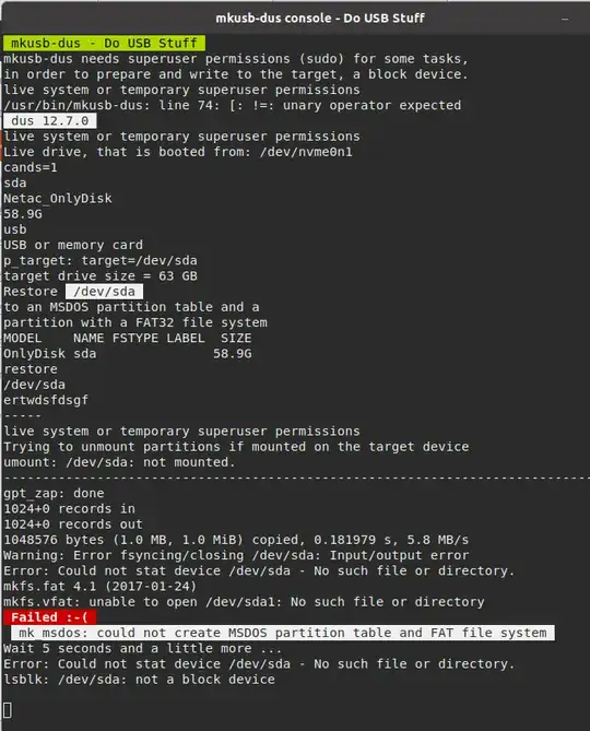

UPD1: Following the suggestion by sudodus, I tried to make use of mkusb tool from this advice, but it resulted with the following error:
