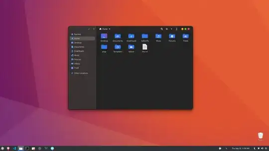

I can't see my Email/Gmail ID in my File Manager
It Looks Like This:

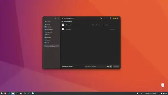

I tried look in + Other Locations Tab But I can't see my Email/Gmail There Too!, it looks like this:

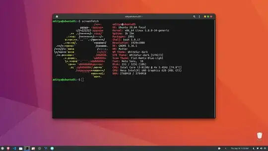

My System Details:
