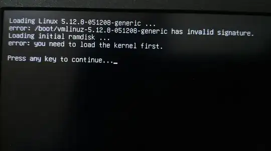

EDIT 2 :

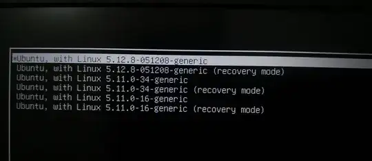

I follow command line steps and downloaded Linux kernel 5.12.8 (1,3,4,6 line *.deb) to install kernel 5.12.8 which support WI-FI 6.
I reboot my laptop and it first shows
to select kernel version. (As by default it selected that kernel which I just installed). I hit enter, and then it shows
What should I do now ?
