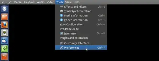

It can be fixed in VLC preferences:
  • Open VLC preferences by going to tools menu
  • In preferences, Enable "Allow only one instance" and "Enqueue files in one instance mode" like shown below:
  • Click save. That's it!
From now on when you open files with VLC they will be enqueued in your playlist.

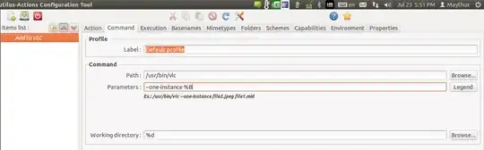

  3. Open nautilus-action-Configuration-Tool.

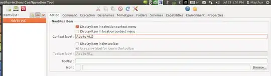

  4. Then click on add new action button and name your action.
  5. Click the Command tab and enter the command
    vlc --one-instance
    You should also enter the appropriate parameter into the Parameters box — you can click the Legend button to see a list of parameters you can use.
    In our case, we want the %f parameter to feed filename or better %B if we may have spaces in it.We can also view all the detailes about the parameters by clicking on the Legend button.
    Nautilus-Actions shows you a preview of the command it will run, so you’ll know you’re on the right track.

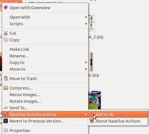

Launch the Nautilus-Actions Configuration Tool from Dash:
In the Action Tab Enter the name you want to save:
In the command tab add the command as below in the picture(path:/usr/bin/vlc and Parameters: --one-instance %B)
Now save and exit, now whenever you right click on a file you can go to Nautlus Actions and choose Add to vlc:
