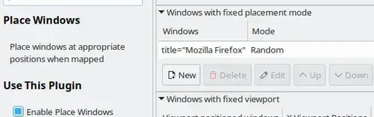

the settings of plasma can be overlaid by the individual apps and some start maximized. therefore e.g. the test with Firefox was unsuccessful. but had effect after using this Firefox addon:
https://addons.mozilla.org/en-US/firefox/addon/change-maximized-to-resizable/
I had previously set Cascade for new windows in 'Windows Managment'> 'Place Windows'> with ccsm. The tool turned off again. It looks like this rule is now in effect. I don't know it's coming from CCSM.
