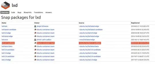

  2. Next, let's head over to https://launchpad.net/lxd/+snaps and find that stable version...

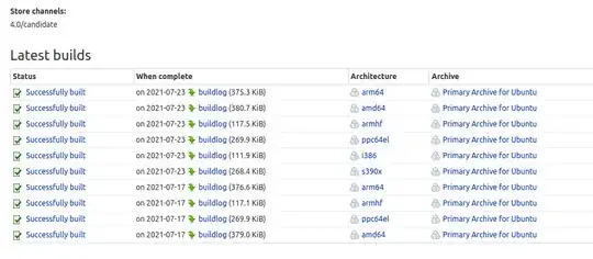

    ...aha. Here it is: https://launchpad.net/~ubuntu-lxc/+snap/lxd-4.0-candidate . You can see the build date --which is after the CVE (good)-- and a link to the build log for each architecture.

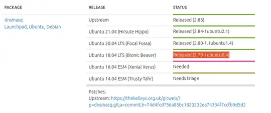

  4. Finally, let's look at the Ubuntu Security Team CVE tracker to make sure that the package is properly fixed. Were the LXD snap using dnsmasq instead of dnsmasq-base, you can see that the build used a properly patched version (highlighted).
    • Remember that we're looking for the 18.04 (Bionic) package, since that's what was used to build the Snap.
