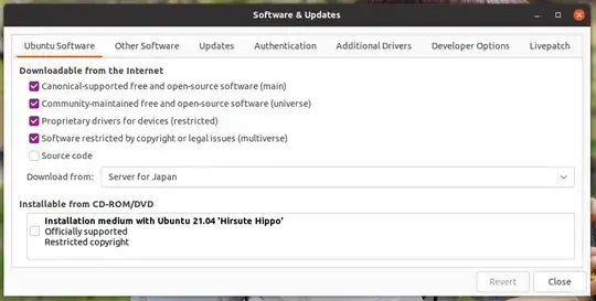

  1. Open the Software & Updates application
  2. Uncheck everything in "Ubuntu Software": Ubuntu Software

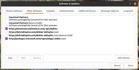

  3. Uncheck everything in "Other Software": Other Software
