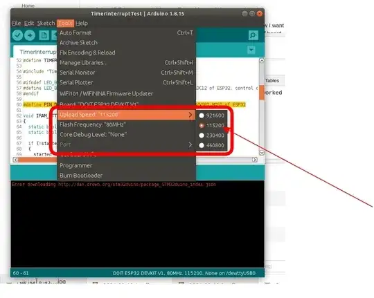

Also use lower baudrate as you can see below: enter image description here
