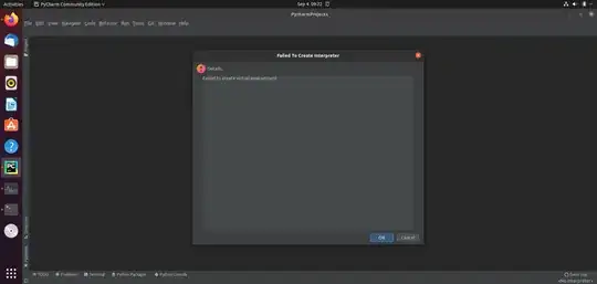

I wanted to run my first python file on ubuntu when suddenly this message with no further instructions appeared:
Failed to create virtual env

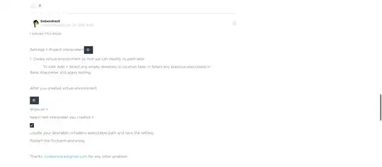

As a consequence I have researched what the meaning of the error was. According to the forum this was the most appropriate solution:
discussion
I have tried it, however the same error message appeared. I also made sure that the location directory where I created my venv was empty. This is the furthest I have come:

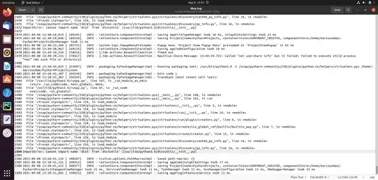

Edit:Error message
Solution: Unable to locate package python3-distutils in Ubuntu 16.04
