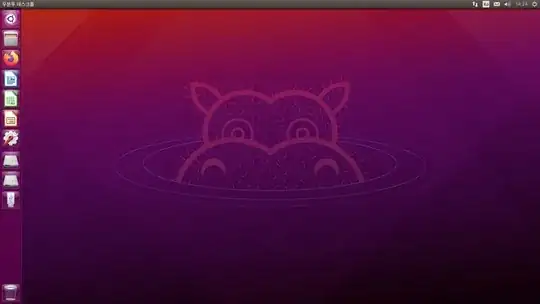

But, it displays like this in my computer:
I upgraded 16.04 to 18.04, then 18.04 to 20.04, then 20.04 to 21.04. How can I fix this UI?
In 16.04, Unity was the default Desktop environment. As you used an unsupported upgrade path from 16.04 -> 21.04 it was not changed after your upgrade. So, you're still using unity-desktop as default.
Install ubuntu-desktop if not already installed and switch the Desktop Environment to Gnome before you login.
sudo apt install ubuntu-desktop
You probably also need to change your Display manager to gdm3 (Default in 16.04 was lightdm). Run sudo dpkg-reconfigure gdm3 and chose gdm3.
However... I guess, you will notice more issues related to using an unsupported upgrade path. If that is the case, you should consider a reinstall.
