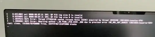

Any assistance understanding what these messages mean and how I can fix them will be appreciated, Dell XPS 15 9510 - BIOS = 1.4.0

I am using Ubuntu 21.04, and I had installed Kernel 5.13, I went back to the original Kernel 5.11 and all the messages went away, I am going to wait for 21.10 with the newer Kernel.
