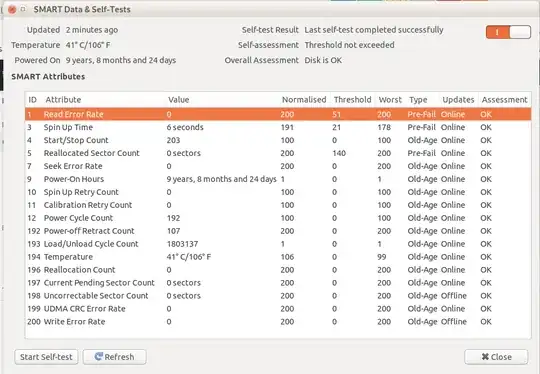

I ran SMART and saw a few features marked pre-fail. (I plan to buy a newer drive and clone the contents of the old one onto its replacement when I can afford to).

HDD Screenshots

I thought HDD is getting too hot. Turns out those are index values.

memtest freezes when run. Suspect bad RAM, or RAM that needs re-seating in its socket. RAM is in slots DIMM0-3. Remove DIMMs1-3 and retest memtest. If memtest runs without error, add back one DIMM into slot DIMM1 and retest, etc.
Update #2:
It looks like your sdc drive has one or more bad blocks. Let's map it out...
Note: do NOT abort a bad block scan!
Note: do NOT bad block a SSD
Note: backup your important files FIRST!
Note: this will take many hours
Note: you may have a pending HDD failure

Update #3:
Since deleting /dev/sda5, you're left with a 28G unallocated hole on your HDD. You can add that space to /dev/sda1.
Make sure that you have a good backup of your important Ubuntu files, as this procedure can corrupt or lose data.
