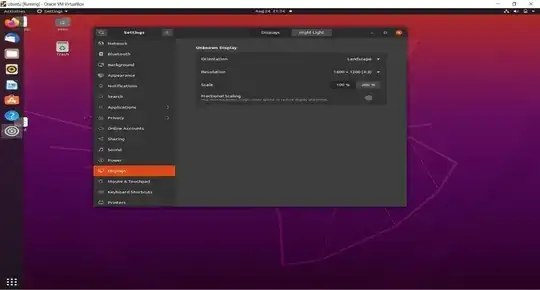

You can change the resolution in your vm ubuntu.
From
settings -> Displays -> Resolution
See this image
