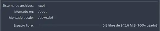

I cannot boot. My PC stays in the logo of the motherboard after selecting Ubuntu from GRUB menu. I have been watching some youtube videos to solve this, since my first error was this:
"unable to mount root fs on unknown-block(0,0)"
I've tried a few things from recovery mode, but it won't let me do anything because I get an error that says that my device has no space.
Now I can boot my PC from advanced options in the GRUB menu by selecting an older kernel version (5.8.0-53).
I realized that my boot partition if full.
Screenshot
The picture says: Free Space 0B (100% used)
Maybe this is the problem, Im not really sure.
Would appreaciate your help, since I dont want to lose my data.
