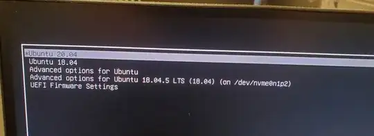

I just did an update to 20.04 and now 18.04 won't boot without choosing a special option. Here is my usual grub screen upon boot:

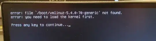

If I choose Ubuntu 18.04 I get this:

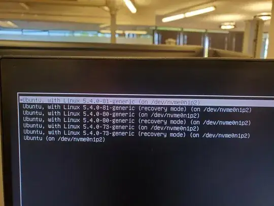

If instead at the main boot menu I choose Advanced options for Ubutnu 18.04.5 LTS (18.04) (on /dev/nvme0n1p2) I get this:
If I choose any of these non-recovery mode options everything boots and works normally.
What I don't understand is why is the usual boot option looking for kernel version ending in 70? It's not there anymore! How can I make it look for one of the kernel versions that is there?

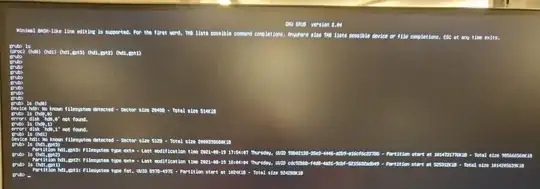

Based on some other posts I also tried pressing c from the grub main menu to do a terminal session, I found the following information but I'm not sure what do to, sorry this pic is a bit blurry:
I'm not sure how to enter a command here to resolve this if that is possible.

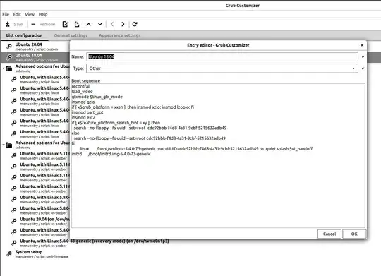

Here is my Grub Customizer edit screen for the regular Ubuntu 18.04 menu item:
I don't understand this b/c -73 is here not -70 ?!?!

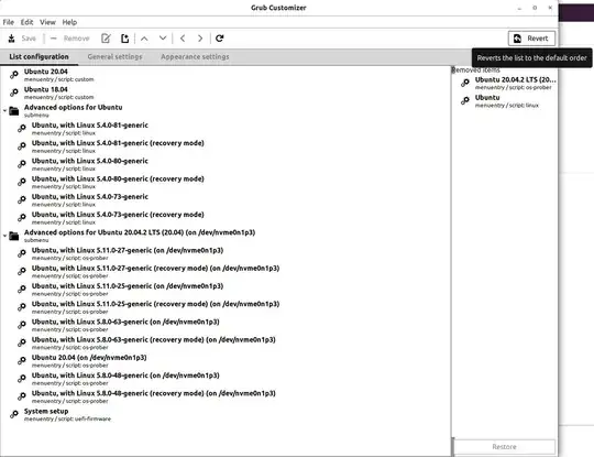

Main Grub Customizer screen:
cdahms
  • 1,993
The default GRUB boot was looking for kernel vmlinuz-5.4.0-70-generic which doesn't exist.
The Additional Options boot was correctly showing kernels -73, -80, and -81.
GRUB Customizer was used to tailor the GRUB menu, and it screwed up. Review the GRUB Customizer menus looking for a custom entry for -70, or for a way to revert back to the standard GRUB menus.
