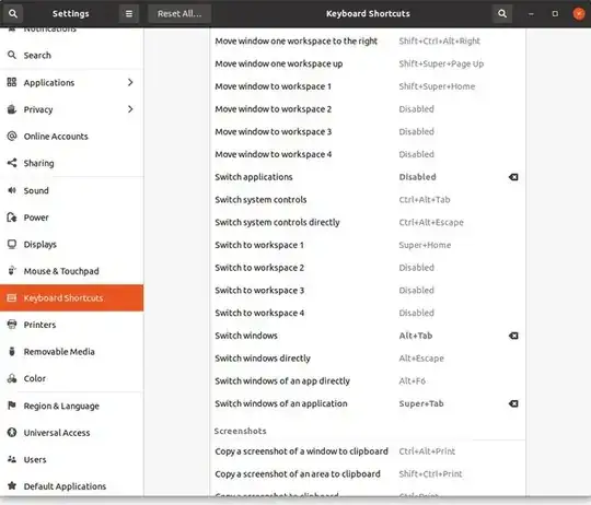

When I switch between windows of the same application, it it doesn't work with all applications:
  • gnome terminal: OK
  • gedit: OK
  • chrome: KO
  • emacs: KO
More specifically, for chrome and emacs it sees only one window while two are open.
At the same time, the window grouping feature works very well in the bottom bar that shows all open windows.
In "preferences" -> "Keyboard Shortcuts", I customized "Switch windows of an application" with "Super+Tab" and disabled "Switch Applications".
Text
Is this a known problem?
I'm on Ubuntu 20.04 running Gnome 3.36.8 flashback (metacity).
Thanks!
