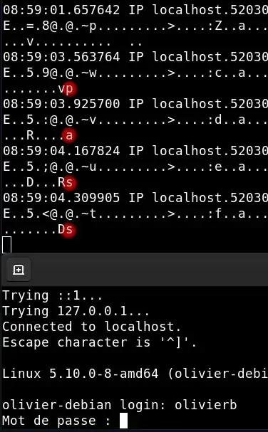

To snif packages, use then tcpdump. You can install with the following command.
sudo apt install tcpdump
Use the following command to display the traffic on port 23 (keep the terminal open, and open a new one).
sudo tcpdump -A -i lo dst port 23
Finally, run telnet on your computer.
telnet localhost 23
Login with your local account, you will see the written text in clear into tcpdump.
