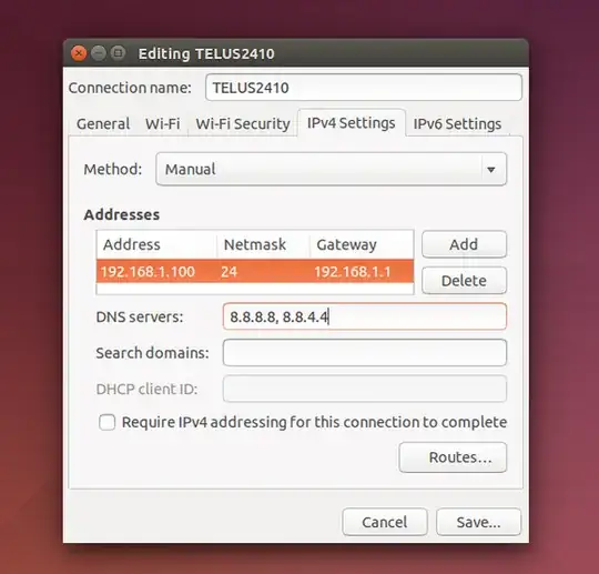

Your netplan yaml file indicates that you are running Network Manager. That is the place to make your changes to DNS nameservers.
