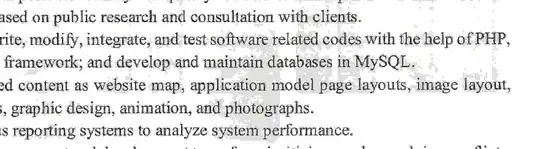

This is part of original image

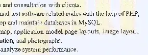

This is part of changed image after command

It's because of how JPEG compression works. It attempts to round adjoining pixels that are similar to eachother to similar values. This causes loss of details, and blockyness.
This becomes more noticeable as you increase the compression level, which is exactly what you're doing. In addition you're doing it in two steps:
  1. Lossless (PNG) to lossy (JPEG) compression.
  2. Lossy to lossy compression.
You will probably get a better result by going lossless to lossy at final quality, thus only applying lossy compression once, e.g. using jpeg:extent=300kb -strip -quality 90 -scale 90% in the first conversion.
Furthermore, you say nothing about the size of the image and level of detail. It may not be feasible to get it down to 300kB and retain the desired quality.
To get rid of background blotches, you can try to apply thresholds to your document in some image editing software, forcing anything less than a certain shade of gray to be white, for instance.
However, no matter what you do, compressing from a 30MB lossless format to a 300kB lossy format will lead to visibly reduced quality.
