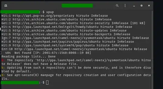

I have a PPA installed which does NOT have a release file for my 21.04 system. Currently, the outdated PPA is stalling anything else from updating. I would like to keep the PPA enabled, but have all other updates and upgrades pass through. Is this possible?
EDIT: 'upup' is just an alias for "sudo apt update && sudo apt upgrade"

SysMonTask Installation
start the terminal and then
wget https://github.com/KrispyCamel4u/SysMonTask/releases/download/v1.3.9/sysmontask_1.3.9-ubuntu20.10_all.deb
or
wget https://launchpad.net/~camel-neeraj/+archive/ubuntu/sysmontask/+files/sysmontask_1.3.9-ubuntu20.10-a_all.deb
sudo apt install ./sysmontask_1.3.9-ubuntu20.10_all.deb
or sudo apt install ./sysmontask_1.3.9-ubuntu20.10-a_all.deb
