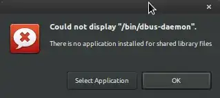

After installing Konquerer and restarting my laptop i got the following error while trying to open, edit or access files as root from within Terminal (which is existencial for me).
root@linuxBox:/home/v2r# gnome-open /home/
(gnome-open:2686): GConf-WARNING **: Client failed to connect to the D-BUS daemon: //bin/dbus-launch terminated abnormally with the following error: No protocol specified Autolaunch error: X11 initialization failed.
GConf Error: No D-BUS daemon running
root@linuxBox:/home/v2r# No protocol specified Could not parse arguments: Cannot open display:
Also it seems, that dbus is not installed properly anymore in /bin/ and /usr/bin/ See screenshot: enter image description here
How would i go about fixing this problem and thank you in advance?!!!
