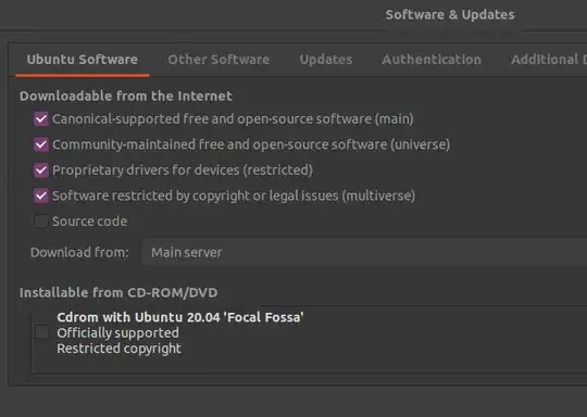

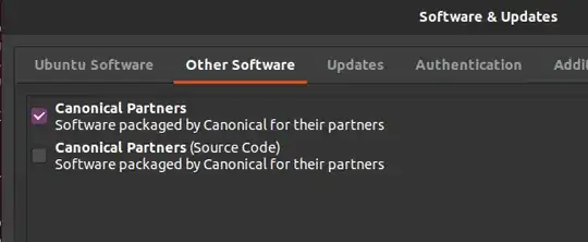

I would like to enable or disable certain options in the application software-properties-gtk via command-line.
Examples of the options that I am interested to control via command-line are shown below:
a b
I suspect the command software-properties-gtk --enable-component=ENABLE_COMPONENT would allow me to implement what I want. However, manpage does not elaborate what values can be used to replace ENABLE_COMPONENT.

On my Ubuntu 18.04 LTS I see the following:
$ software-properties-gtk --enable-component=main
The --enable-component/-e command-line switch has been
deprecated. Instead of 'software-properties-gtk -e multiverse'
you can use 'add-apt-repository multiverse'
So really you have to use
add-apt-repository component
where component is one of the following:
  • main - Canonical-supported free and open-source software.
  • universe - Community-maintained free and open-source software.
  • restricted - Proprietary drivers for devices.
  • multiverse - Software restricted by copyright or legal issues.
So the full commands would be
  • sudo add-apt-repository main
  • sudo add-apt-repository universe
  • sudo add-apt-repository restricted
  • sudo add-apt-repository multiverse
For Canonical Partners you can use the command shown below:
sudo add-apt-repository "deb http://archive.canonical.com/ubuntu $(lsb_release -cs) partner"
where lsb_release -cs will return the codename (bionic, focal, hirsute, etc) of your Ubuntu version.
