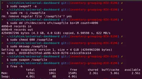

While it didn't answer my original question, since increasing the swap to 4G I don't experience any more computer freezes, so I accepted the answer
EDIT
As @heyynema suggested, I ran the following operations enter image description here
I'll report back in a few days whether this has solved/improved the issue

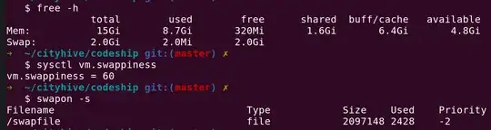

OP
I'm running multiple dev related processes on my machine in the background, i.e. vscode, dev servers, etc
every once in a while my laptop kinda freezes almost entirely for about 30 seconds, and then everything goes back to normal.
during the "freeze" if I move my mouse I can see the cursor moving around very slowly with a huge lag.
Is there a way to identify which process is causing this?
I don't know much about memory and monitoring, is there an alert I should set up, i.e. "if any process exceeds X memory then log Y"?

You have plenty of RAM. But historically a 2G /swapfile has proven to be too small. We'll increase yours from 2G to 4G...
Note: Incorrect use of the rm and dd commands can cause data loss. Suggest copy/paste.
In the terminal...
sudo swapoff -a           # turn off swap
sudo rm -i /swapfile      # remove old /swapfile
sudo dd if=/dev/zero of=/swapfile bs=1M count=4096
sudo chmod 600 /swapfile # set proper file protections sudo mkswap /swapfile # init /swapfile sudo swapon /swapfile # turn on swap free -h # confirm 16G RAM and 4G swap
Edit /etc/fstab, using sudo -H gedit /etc/fstab or sudo pico /etc/fstab.
Confirm this /swapfile line in /etc/fstab... and confirm no other “swap” lines... use SPACES in this line... confirm NO TABS...
/swapfile  none  swap  sw  0  0
reboot                    # reboot and verify operation
