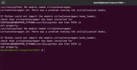

I'm using Ubuntu 20.04 (clean installation, I did not upgrade from a previous one) and when I open a new terminal (simply by Ctrl+Alt+T), it always starts with the output shown below (also shown in the following screenshot):
/usr/bin/python: No module named virtualenvwrapper
virtualenvwrapper.sh: There was a problem running the initialization hooks.
If Python could not import the module virtualenvwrapper.hook_loader, check that virtualenvwrapper has been installed for VIRTUALENVWRAPPER_PYTHON=/usr/bin/python and that PATH is set properly. /usr/bin/python: No module named virtualenvwrapper virtualenvwrapper.sh: There was a problem running the initialization hooks.
If Python could not import the module virtualenvwrapper.hook_loader, check that virtualenvwrapper has been installed for VIRTUALENVWRAPPER_PYTHON=/usr/bin/python and that PATH is set properly. daniel@daniel-Inspiron-5482:~$
unclear terminal
Of course I have already tried to execute reset and reboot.

I have also installed the packages virtualenv and virtualenvwrapper and updated using sudo apt, but the problem still accrues.
What is the problem with my terminal actually?
The problem is with this entry in your ~/.bashrc file:
# Virtual Environment Wrapper
source /usr/local/bin/virtualenvwrapper.sh
  1. It's a duplicate entry. You only need one, so just remove the other.
  2. Make sure that the path to virtualenvwrapper.sh is the correct one by running the following command and replacing /usr/local/bin/virtualenvwrapper.sh with the command's output:
    which virtualenvwrapper.sh
    If the path is already the correct one, then great! Just skip this step.
  3. You need to add these commands (that you also mention in your question) right before source /usr/local/bin/virtualenvwrapper.sh in your ~/.bashrc:
    export VIRTUALENVWRAPPER_PYTHON=/usr/bin/python3
    export VIRTUALENVWRAPPER_VIRTUALENV=/usr/local/bin/virtualenv
    Again, you should make sure that the paths are the correct ones.
  4. After doing the above, restart your terminal or run:
    source ~/.bashrc
Your terminal should start properly now, without the error text, and virtualenvwrapper should work as expected!
