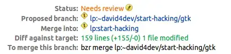

Once the review has started, you will see something like this in the 'Code' tab: alt text
You can follow this link to the review page. alt text
Once the reviewer is satisfied, they will merge the branches and your code will become part of the project's trunk.
