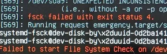

fsck failed with exit status 4
failed to start file system check on /dev/disk/by-uuid ubuntu
/lib/systemd/system-generators/friendly-recovery failed with exit status 1

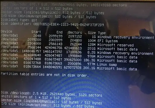

I also executed sudo fdisk -l and below is the output
I believe the Linux files system is /dev/sda9. I was expecting to see Linux filesystem, confused why it states Microsoft basic data
Below is UEFI error as reported from Journalctl -xb
Note: By executing fsck /dev/sdxI was able to resolve failed to start file system check. Review fsck error in the reference for additional details
