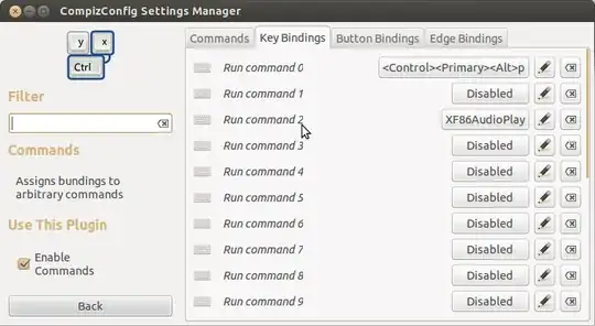

Your command in comments seems fine. Best way to set, if using compiz, is in ccsm > Commands. (you also need to have the dbus plugin enabled.
Then for command enter as commented dbus-send --type=method_call --print-reply --dest=org.mpris.MediaPlayer2.vlc /org/mpris/MediaPlayer2 org.mpris.MediaPlayer2.Player.PlayPause
Enable it to the media key in the key bindings as seen in screen, here it's run command 2, when going to the set 'key combo', I just used the media play/pause on keyboard, ie. no combo

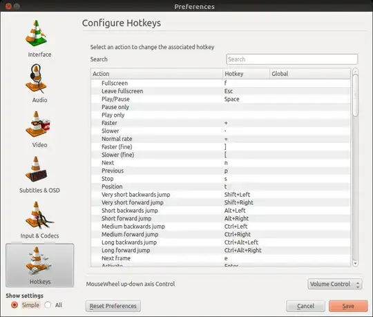

ASAIT, VLC cannot be bind to System Audio shortcuts like Rhythmbox or Banshee or Totem. It has its own HOTKEYS interface. The only way I found is the Playlist Hotkeys thing:
  • Press N for Next audio/video track
  • Press P for Previous audio/video track
  • Press SPACE to pause/play track
  • Press S to stop track.
Though, the VLC Window should be active in order for the hotkeys to be active too.

VLC Custom Shortcuts in Unity Launcher
VLC Hotkeys
VLC Hotkeys
