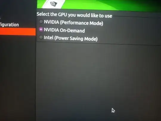

Using Nvidia on demand driver(U can configure this from Nvidia X server settings application)
has improved my battery backup twice(3 hrs now), though lesser than what I used to get while using windows i.e, 5hrs.
On the other hand, I didn't observe any significant change after turning on the power-saving mode(i.e battery backup of 1.5 hrs only).

Update: I have found this answer as the most appropriate one, that actually improved my battery life from 3 hrs to 4.5 hrs(on a full charge). So In case, it solves your problem too, plz upvote his answer.
