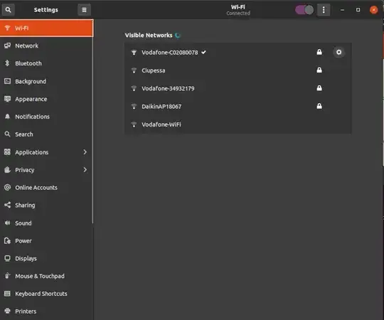

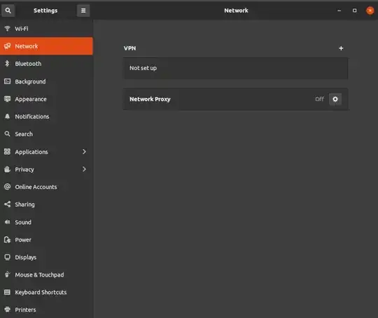

As you can see, the system doesn't recognize any wired connection settings:
While it does with the WIFI connection settings:

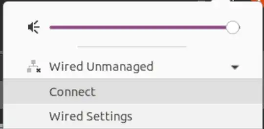

applying the modification, and rebooting the system, I can now see: Network Unmanaged:
But, clicking on Connect doesn't make the Ethernet Connection work and still the Wired Settings do not show up:
What else should I check? How to solve the problem?
