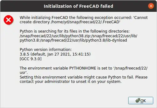

- As well somewhere else, installing FreeCad , I see the following message that seems to be related to the same problem:

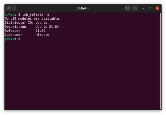

Remark: Checking Ubuntu version, I do not see LTS mentioned. Is this a problem?
From previous inquiry, I understood that the correct version of libpython3.8 on Ubuntu 20.04 is 3.8.10-0ubuntu1~20.04
