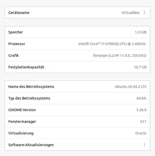

According to https://wiki.ubuntuusers.de/Caffeine/ there should appear a settings dialog, after rightclicking the Caffeine symbol. That does not work for me with Ubuntu 20.04.2 LTS and Caffeine 2.9.4 How can I reach the settings?

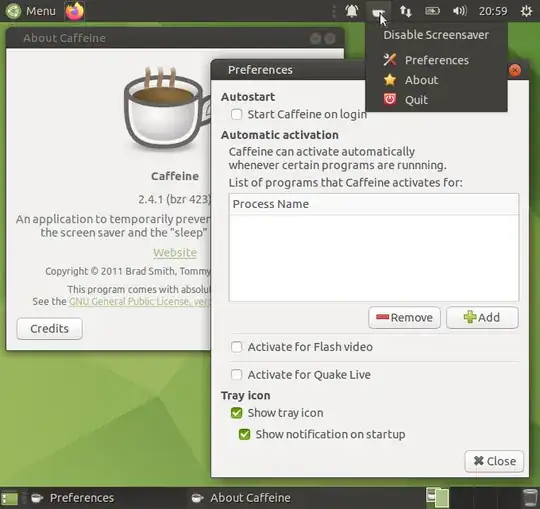

and then Caffeine will show (at least on MATE, the fork of GNOME 2.3x) its Preferences as it was in 2013:
Caffeine on MATE
