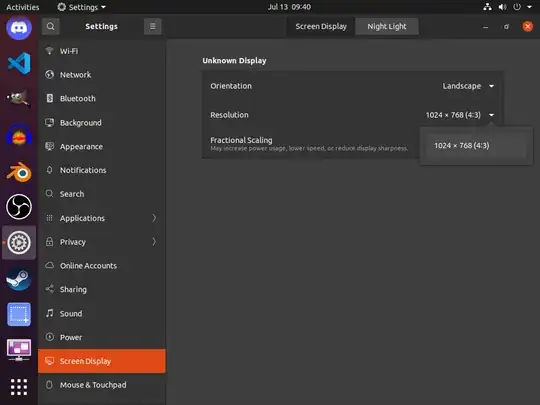

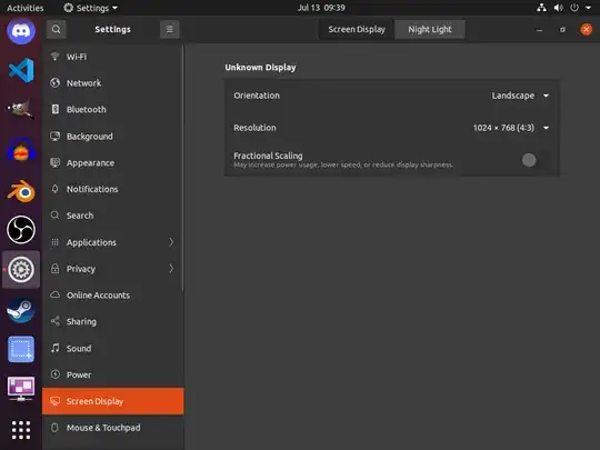

on ubuntu 20.04 it wont let me set native resolution I try to set the screen resolution to 1920x1080 (16:9) but the option doesn't show and the only option is 1024x768 (4:3)
Screenshot of display settings
