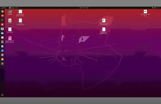

In this machine, we have Ubuntu 20.04 (i suppose). After a few hardware configurations (some cables) (i don't really know about to explain), the mixxx software doesn't open.
So, it shows up in the Activity bar but then it doesn't open.
