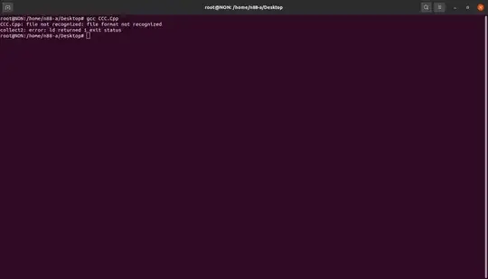

When I run the command gcc CCC.Cpp I get this error:
CCC.Cpp: file not recognized: file format not recognized
Collect2: error: ld returned 1 exit status"
This is the content of CCC.Cpp file:
#include <iostream>
using namespace std;
int main(){cout << "CCC";return 0;}
Error message

You have to rename the file from CCC.Cpp to CCC.cpp first and then compile your application by G++ (C++ compiler).
Reproducible way:
sudo apt-get install g++
mv CCC.Cpp CCC.cpp g++ CCC.cpp -o CCC ./CCC
Also you should not use root account for daily non-administrative task.
