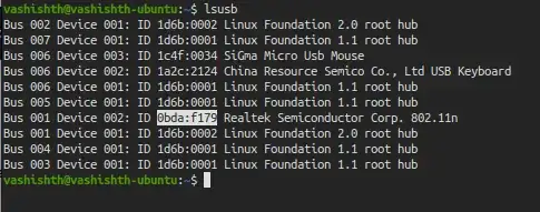

i am a new user in ubuntu and i am unable to install my wifi adapter driver i.e of adnet 802.11n please help i had uninstalled my previous windows os
First check your USB configuration by typing lsusb in your terminal and check it.. see the image for more info..
If your USB configuration is this 0bda:f179 Then you can try this following commands...
