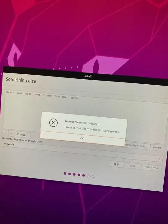

I am trying to install Ubuntu into a 3 graphic card z390 motherboard with 1 DDR4 on i7 CPU.
But I'm stuck in installation type no partitions
Photo of the error
No root file system is defined.
Please correct this from the partitioning menu.
From your image I see an empty drive.
press + to create a partition that should/could be ext4 and mounted on /
press + to create another one also ext4 and mounted /home (so your data is separated from system).
You can go from there...
on sizes:
My recomnedation would be 60Gb to 120GB for /
120+GB for /home (depending on your plans and what you will install)
