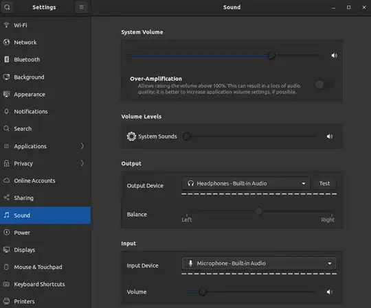

Only built-in mic is detected

After this, when I plug the headset in, a pop up will show up for me to choose the type of plugged-in device, then I can choose headset and use the microphone. I only works when I add BOTH models: laptop-amic and dell-headset-multi (1 minor issue with this solution: there is 1 redundant microphone option in Audio setting) Image of redundant option:redundant option
